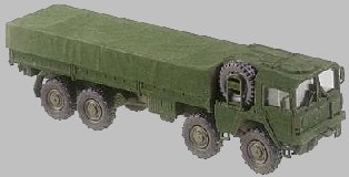

I like this model I found in overlanders thread, maybe I can find another one or use Roco's:

Roco's MAN 8x8, I'll order one soon.
It would be cool to build a custom cargo box for the rear, since I see much bigger ones.
You see different types of "cargo" to putt some sponsors on, it would be cool to design my own, just big enough to cover all the electronics. Nice protective cage on this one!, would be great to copy this.
