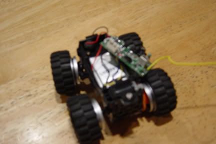

It's geared as high as you can go and still does it. BTW, pics:
It still fits under the stock cover for sleeperness:
Also, here's my little mod so I didn't need to put plugs on the MT:
I made a notch and removed the wristband attachment so the plug would sit there:
Done:

Whats thyat mod for? So you can charge it? Do you have it quad celled or something? What charger you useing?

Quote:
look at the MT pics. That's a 3.6 volt li-po shoved in there, so therefore you need a different charger.
