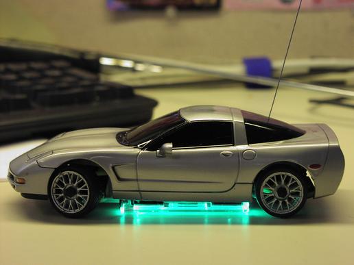

Chevy C5 Corvette Body
Ford SVT Cobra body and bodykit upgrade
Command Logic head/tail lights
Command Logic underbody neons (green)
Wheel upgrade kit

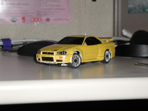

Nissan Skyline
Front suspension: Medium springs on upgraded damper shafts
Rear Suspension: Hard springs on upgraded damper shafts
Front Tires: Hard tread compound
Rear Tires: Hard tread compound
Motor: Stage 2 XMODS
Gearing: 3.82 (Blue, 11 tooth)
Toe Alignment: 0*

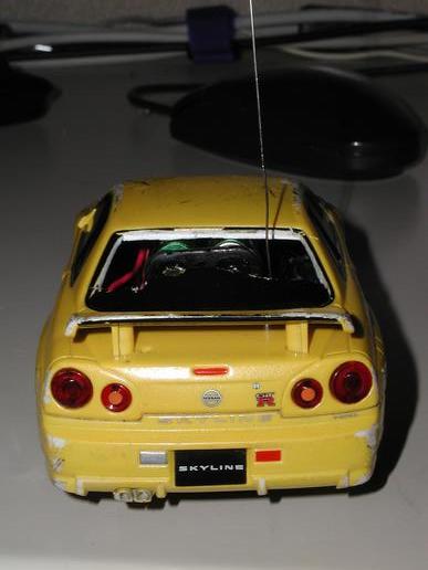

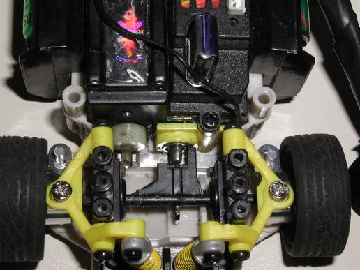

6-Cell mod, front:
From behind with the body on:

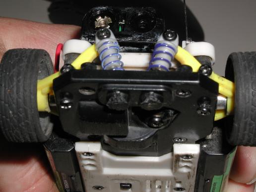

Camber Screws (under the control arms, close to the wheels, hanging from the rear deck):
Aluminum steering bits:

When I'm not racing, I put the Corvette body on the built-up one, but I can't fit 6 cells in it.
