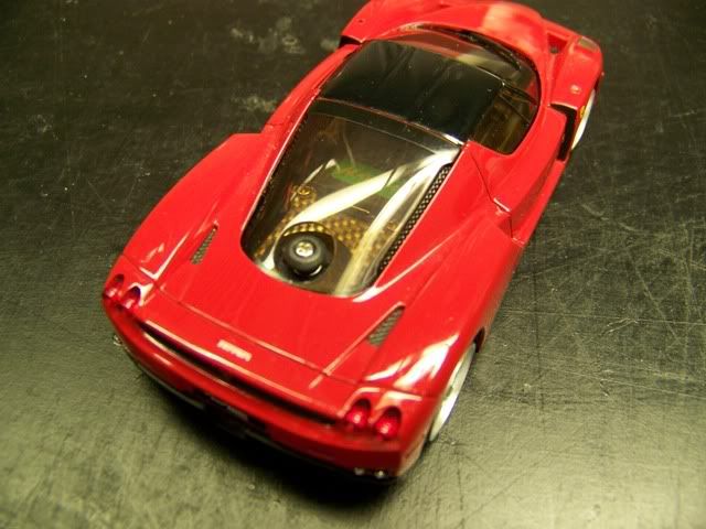

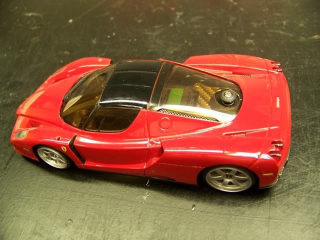

The DDS worked well and calmed down the rear of the car, BUT two with issues:
The holes in the discs are a bit large or the post is a bit small because there is a significant amount of play. The dampening doesn't start working till the post contacts the disc and you can feel this happening, especially with some fluid on the discs. This transition unsettles the car. I ended up sticking one of the metal washers included in the Atomic H-Plate kit into the recess of the upper disc. The washer fit the damper post closely, this took out the play to this disc at least and the car behaved better. I will have to make up a larger post or sleeve the existing post to fix this. Smaller holes in the discs would solve the problem too.
Also, I had to cut a hole in the car... (pictured below)

so if i read your post the product isn,t that good at all (before modding)
if you have too tweak that much , and you can,t make the holes in the disk smaller.
and i don,t like to cut a hole in the back ( that,s pesonal )
but thanks for the revieuw but i wait for a mabey a second version

the hole doesn't bother me nearly as much as the concern regarding excessive play in the parts.
it's unfortunate that the first batch of parts from atomic all seem to require some revision/refinement. they've had over a year to get this prototyping done.

I also feel the hole in the carbon friction plate is much too large and the discs took a bit of sanding to get them flat. Since I might replace a few of the parts I think I spent 20 bucks on some springs and screws.

Interesting review. Another let down on Atomic's Dnano hop-ups. First, their ball differential looked promising but required some mods I believe, and now this? I thought they were pretty good with the Z's and this wouldn't have been much different? Or is it because it's smaller, it's harder to make precise? I'm rather disappointed at this moment.
While I generally buy hop-up's to look good, I want theme functional as well and these two upgrades from Atomic don't sound all that hot after all.
I am not an expert at perfecting something that requires working on and modifications in order to work properly. I'm much more of a plug'n'play type of guy and I like things to work instantly right out of the package.
I'm very glad for these reviews as it saves me money on purchasing these items that require fudging to work. Thank you, and thank's for the pictures!
I admit though, the disc-damper does look good, but I'd hate to drill a hole in my cars window for it to work. Might as well have a long antenna sticking out the back of it too.
Good luck with it and let us know how it handles on the track and during actual racing!
